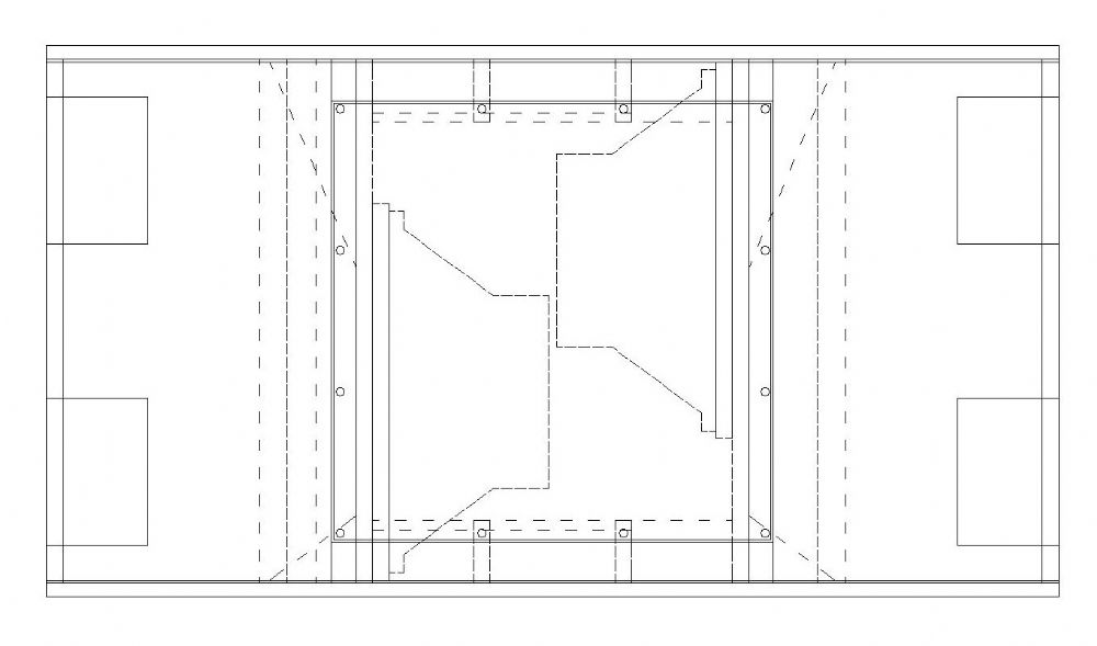

Post Options Post Options   Thanks (0) Thanks(0)   Quote Teunos Quote  Post ReplyReply Direct Link To This Post Posted: 04 September 2020 at 9:15am
Have you considered how you are going to mount the drivers in this arrangement?
Attraction/repulsion of the magnets will make assembly a pain especially if using ferrite drivers.

Post Options Post Options   Thanks (0) Thanks(0)   Quote snowflake Quote  Post ReplyReply Direct Link To This Post Posted: 04 September 2020 at 1:28pm
the whole driver baffle will be removable so I can mount the driver on the baffle before putting it into the speaker. bolts connecting baffle to the box can be positioned to make it easier to tighten the bolts. Rear panel and front panel are removable. I was imagining turning the box on one side and bolting down one driver, then flipping it 180 degrees and sliding the the other driver in underneath it and bolting it down. magents won't overlap that much but will only be 15mm clearance at one point. maybe I should cover the first with something if there is any danger of them attracting each other and chipping the magnets.

Post Options Post Options   Thanks (0) Thanks(0)   Quote snowflake Quote  Post ReplyReply Direct Link To This Post Posted: 04 September 2020 at 1:49pm
with B&C 15RBX100 driver. theres slightly more clearance than shown as the edge of the magnet is angled.
EDIT: looks like B&C have recently discontinued the 15RBX100

Post Options Post Options   Thanks (0) Thanks(0)   Quote snowflake Quote  Post ReplyReply Direct Link To This Post Posted: 14 September 2020 at 12:33pm
Beyma 15LEX1600Nd and B&C 15SW100 will both outperform the BMS and are cheaper. Confirmed they will fit after getting more detailed drawings with magnet dimensions.Also Beyma 15LEX1600Fe - slightly enlarged rear chamber so that it will fit with 10mm clearance between magnets.
15LEX1600Nd highest output, lightest 20mm clearance between magnets 373mm
15SW100 (8R and 4R) 10mm clearance 374mm bolts 15mm flange
LF15X401 loads of clearance between magnets (no demodulating ring) 371-376mm 15mm flange
15LEX1600Fe cheapest to buy 10mm clearance 373mm 16mm flange inc. gasket
15TBW100 (8R and 4R) cheapest recones, heaviest, 5mm clearance 374mm 14mm flange
LaVoce WAF154.00 and WAN154.00 (373mm) but not readily available in UK

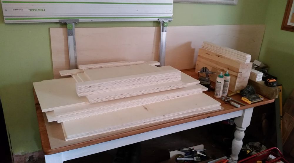

Post Options Post Options   Thanks (0) Thanks(0)   Quote snowflake Quote  Post ReplyReply Direct Link To This Post Posted: 09 June 2021 at 10:33pm
finally building it Smile
