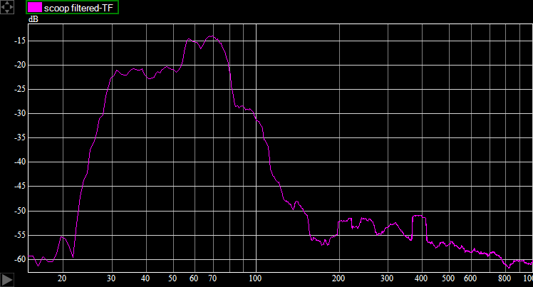

Right then
Graphs
This is 4 x polar bear scoops measured outside
Single double 21"

Our 21's. One box response.
Points: 10932
Post Options Post Options   Thanks (0) Thanks(0)   Quote toastyghost Quote  Post ReplyReply Direct Link To This Post Posted: 19 January 2018 at 2:47am
So that’s two rear loaded horns (scoops) that show -10dB at 30Hz, even with one of them being four boxes in one stack so a larger horn mouth...

Post Options Post Options   Thanks (0) Thanks(0)   Quote JonB67 Quote  Post ReplyReply Direct Link To This Post Posted: 19 January 2018 at 8:05am
Cheers for posting the graphs guys.
So basically the data says they don't got as low as a double reflex of similar size but they push out more spl. Fair trade-off.
Seems in real world usage people in certain scenes like them and find the frequency response fine.
Don't really see the issue? I guess that the people that like them are claiming that they do have the extension in clusters but haven't backed it up with hard evidence?
Unless someone can point me to a scoop thread with this information?

Post Options Post Options   Thanks (0) Thanks(0)   Quote nickyburnell Quote  Post ReplyReply Direct Link To This Post Posted: 19 January 2018 at 8:32am
Looks like my educated guess from listening with tones of -6-8 @ 35 was pretty good?
Eq up with strong driver and voila

Post Options Post Options   Thanks (0) Thanks(0)   Quote Elliot Thompson Quote  Post ReplyReply Direct Link To This Post Posted: 19 January 2018 at 10:47am
A Properly designed Double Reflex (Note: using drivers aimed solely for reflex cabinets) will surpass Scoops from 40 Hertz downwards whereas, Scoops will surpass reflex from 55 Hz upwards due to horn loading. This is based on a box versus box comparison.
The problem with many is not understanding the TS Parameters, using drivers that are aimed for Horns and Reflex loading, receiving adequate results using a reflex while, achieving excellent results in a Scoop. I have roughly 20 18-inch drivers retired sitting in cardboard cartons that could not meet the criteria needed for my reflex designs that were standards in Scoop cabinets 20+ years ago.
There is a reason why, I can get away using no HPF while achieving 20 Hz with no ill affects. Understanding the TS Parameters, will give one a greater chance of achieving their goals.
It is basic logics. If you have 4 Scoops that is -10 dB @ 30 Hz, and 4 Double Driver Reflex Cabinets that is 0 dB @ 30 Hz, the Scoop Cabinets are -10 dB @ 30 Hz compared to the Double Driver Reflex Cabinets when all cabinets are fed the same SPL at a starting point of 100 Hz.

Post Options Post Options   Thanks (0) Thanks(0)   Quote Sinai Sound Quote  Post ReplyReply Direct Link To This Post Posted: 19 January 2018 at 12:24pm
Just for comparison sake
This was measured indoors -  4 polars again
30hz 48db BW- 80hz 48db BW
Edited by Sinai Sound - 19 January 2018 at 12:24pm

Post Options Post Options   Thanks (0) Thanks(0)   Quote toastyghost Quote  Post ReplyReply Direct Link To This Post Posted: 19 January 2018 at 12:43pm
Curious why you went for 8th order slopes?

Post Options Post Options   Thanks (0) Thanks(0)   Quote luton_soundman Quote  Post ReplyReply Direct Link To This Post Posted: 19 January 2018 at 12:58pm
all scoops are different plus different amps and processing. Most roots dances i go to i dont hear or feel any 30-40hz. Alot of sounds virtually playing from 50hz up due to the amount of boost in the higher region. Even tho their hpf says 35hz etc its not there. Some people think if they see a graph its gospel. The graph only represents that individual and what he/she did during the measurement.

Post Options Post Options   Thanks (0) Thanks(0)   Quote Sinai Sound Quote  Post ReplyReply Direct Link To This Post Posted: 19 January 2018 at 1:01pm
These are what Mikko took years back ;)
They were in in the original polar bear thread here
