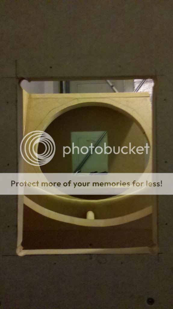

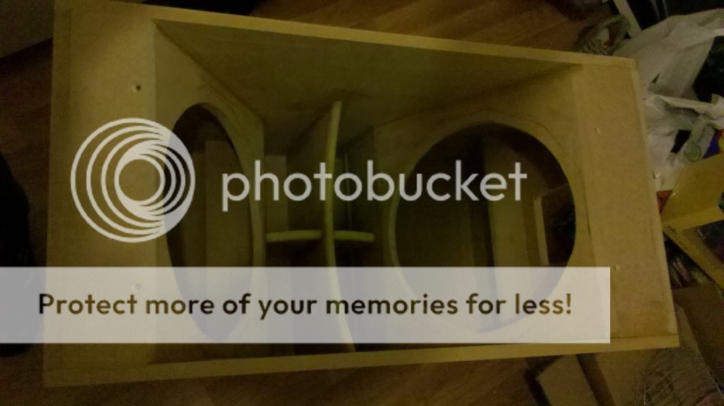

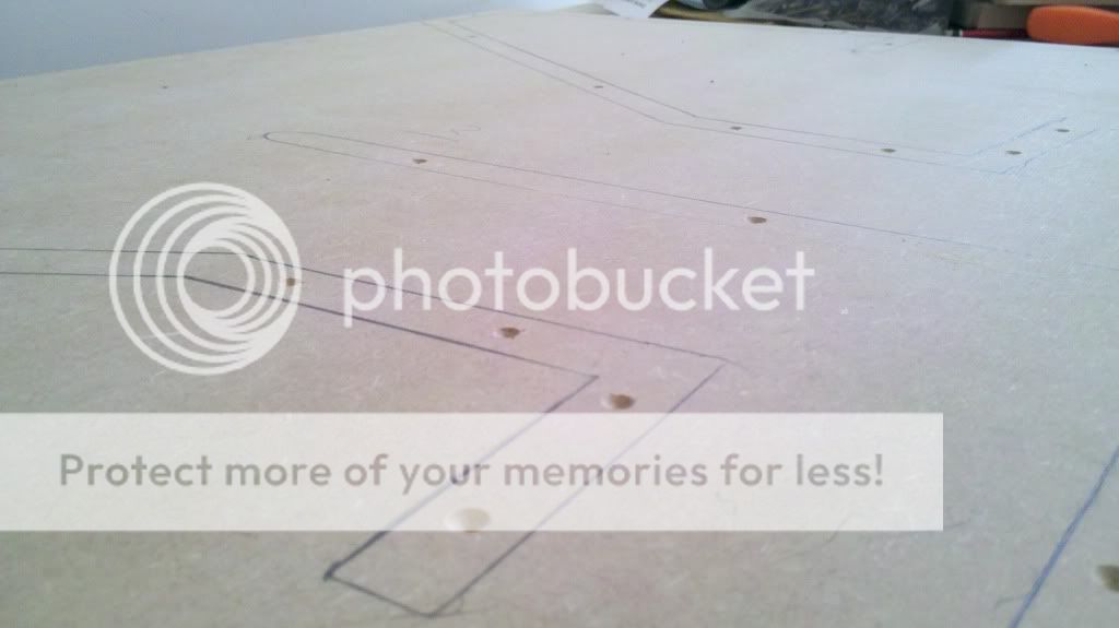

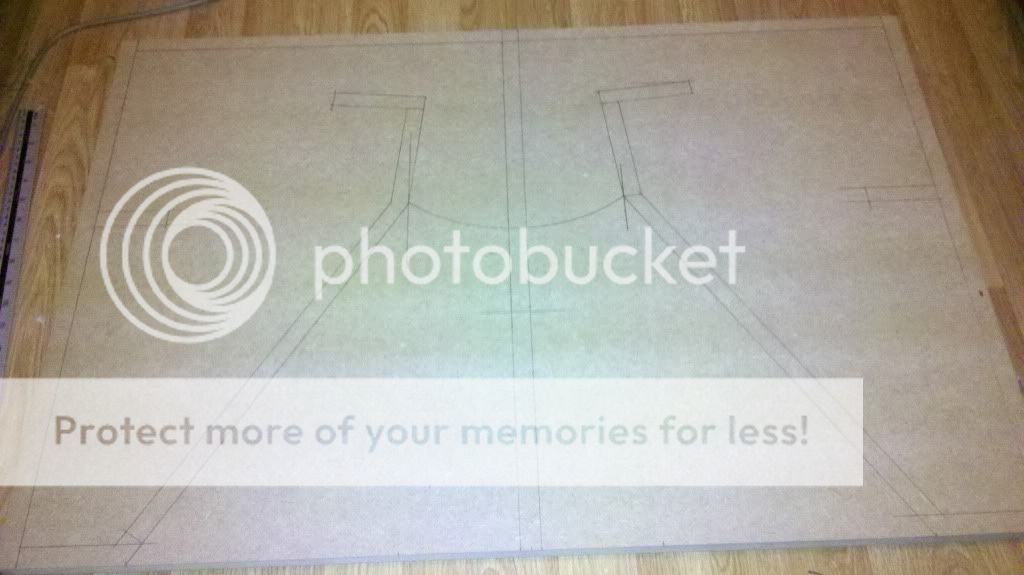

and here are some pics of my build so far
yes I'm using mdf!
the above piece I cut the wrong size for both the right and left so I had to cut two more pieces the correct size
of course I am also adding several bits of bracing that are not on the original plans
Will add some more for you as I get more done
any comments welcome!

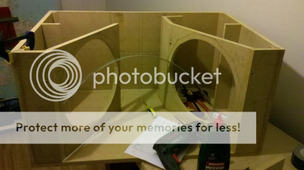

Got all my bits of wood together and I'm quite happy so far!

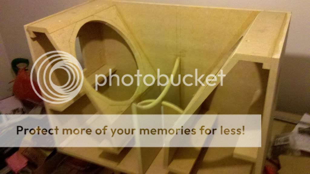

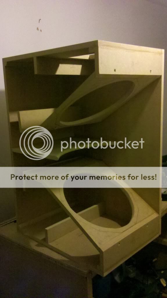

Both sides done and centre in place

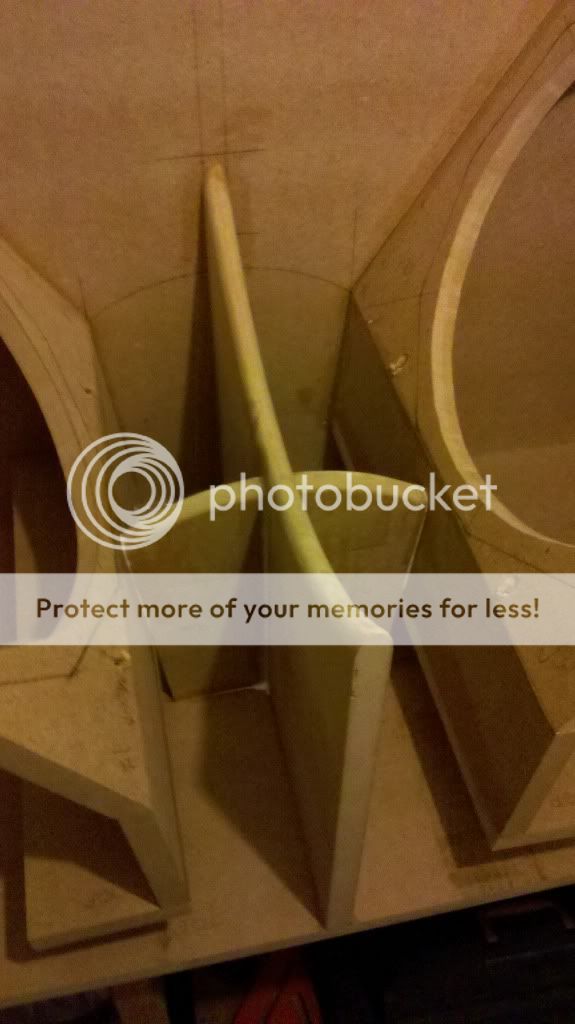

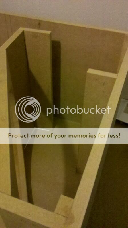

I made the cross braces from one of the baffle cutouts, using the same curve
Decided one handle per side would be enough as I'm not intending on lugging it about too often

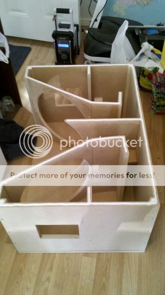

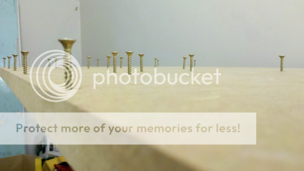

Got the top piece marked out and countersunk
Glue time!

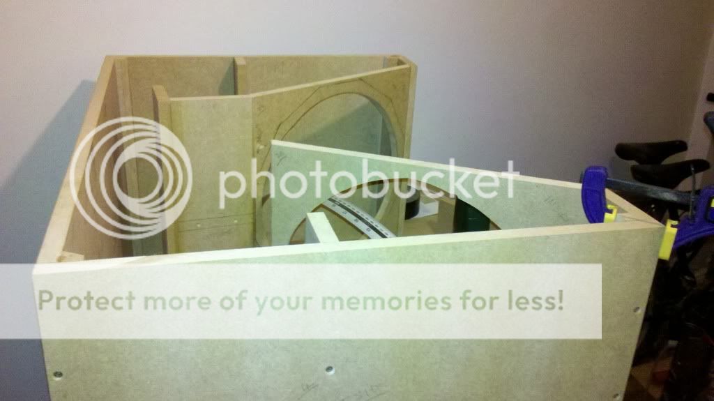

Lid finally attached
Could somebody please let me know whether this type on cab will benefit from wadding? Thanks

i dont know the plan well but if you have made it smaller, you would do well to put a good bit of wodding in the cab to trick the driver into seeing a larger vb.

That looks a very neat job. One thing I would say about the bracing though, MDF had very little Integral Strength, so although acoustically you can get away with the material for the main build, Plywood bracing would be more solid.

Looks good, i think the PD156 should work well in this cabinet.

Thanks guys! I have taken my time to try and get everything right first time. The single most useful bit of kit I bought for this job has been my 1m metal ruler, you can't take too many measurements!
I'll put some wadding in then but I'll keep it away from the port though so it doesn't do any funny business. I'll bear that in mind for anything I make in the future Tony, thanks for the tip.
Next jobs are filling the countersinks, then sanding and painting
