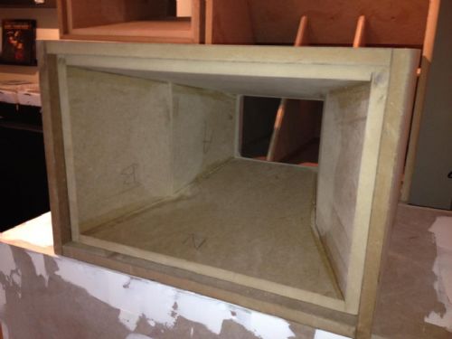

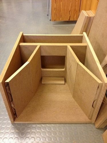

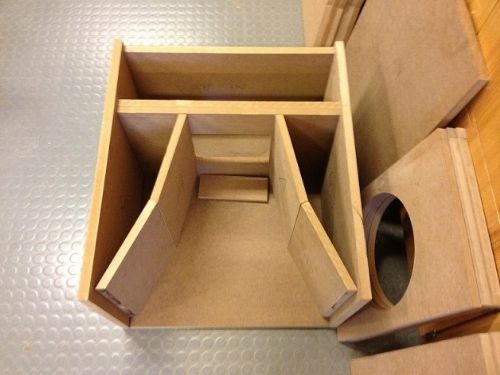

Post Options Post Options   Thanks (0) Thanks(0)   Quote TuffRyder Quote  Post ReplyReply Direct Link To This Post Posted: 26 June 2012 at 10:19am
Here´s som pics of our version of the MT121. From the beginning we planned on making a version of MT122´s but we realized that there would be some hight issues and decided to build them as singles instead.
Didn´t really have time to take lots of pics. We´ve spent about 2 evenings and got one cab almost finished and all the other parts for the remaining 3 cabs.

Post Options Post Options   Thanks (0) Thanks(0)   Quote TuffRyder Quote  Post ReplyReply Direct Link To This Post Posted: 26 June 2012 at 10:20am
Oh and the cab on the pics isn´t glewed or screwed yet. Only dry mounted.
//Tuff

Post Options Post Options   Thanks (0) Thanks(0)   Quote Vert Quote  Post ReplyReply Direct Link To This Post Posted: 26 June 2012 at 8:21pm
Nice and neat joinery Thumbs Up

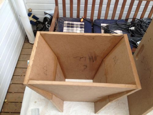

Post Options Post Options   Thanks (0) Thanks(0)   Quote TuffRyder Quote  Post ReplyReply Direct Link To This Post Posted: 27 June 2012 at 10:56pm
Some more pics.
