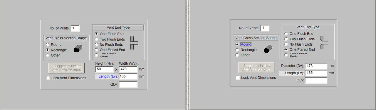

I have a BR design with a slot port without flare, but i need to convert it to a flared oval shaped port.
Slot port is 50x470mm and 185mm long. Should give 4,3475 Liters.
Am i on the right track if i make a port with the same crosssectional area and length as the slot port?
What does the flares do for the total length of the port?
The goal is to ad a 25mm radius flare at both ends.
What would the total length of the 185mm long port with 2x radius 25mm flares be?
From what i understand i have to take the effective length (185mm) and add half of the flare radius (12,5mm) to the effective length of the port.
In this case that would be 185mm + 12,5mm + 12,5mm = 210mm.
That will end up being a 235mm long port including the 2x radius 25mm flares.
Is this total bull?
And finally, what would these changes do to the sound and performance?
