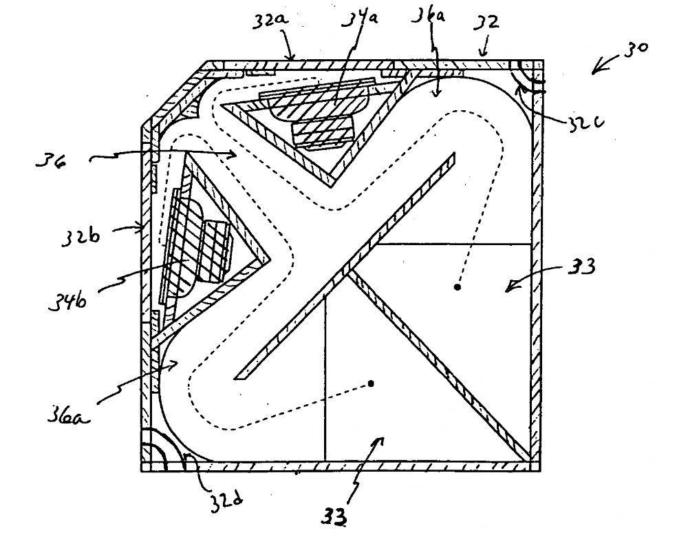

This is from the patent, so in the public domain.
The shelved response is probably why it sounds punchy.

This BDeap uses drivers which must be very close to the Eminence LAB12 as used for LABhorn, since both were developed same time by Danley.

Yea I already considered to just build the Bdeap because of the puplic domain. Just currently don't have the exact internal dimensions because the patent paper only includes the layout and ya can figure out the horn length but exact once might be ofcause best.
The only issue with them are that I would need to use for example scaffolding for the tops because the tops are 800mm deep with the Bdeap being quite short in the depth (something like 600mm? Or soemthing like that)
So a modified version which would allow to lay them on the side like the bc115 would be ideal but wouldn't know what's the way to design the modification altho I can imagine there prob some not too complex maybe.

Do you know the total dimensions for the box? I can figure out the internals based on this pic and those measurements

http://www.best4show.com/files/produkte_2_SPL-Bdeap-32.pdf
Here is the tech sheet  and I just realised I talked totally BS above about the depth... Excuse me.
106x106x46 cm
The mouth size I atm can't find but I could calc it from just a pic I guess. Question is always how much the internal varies from the patent registration.

Just start a cad drawing using those dimensions, and see if you can fit LAB 12 drivers in there, just as shown. If that fits, most other dimensions should also be close to reality.
