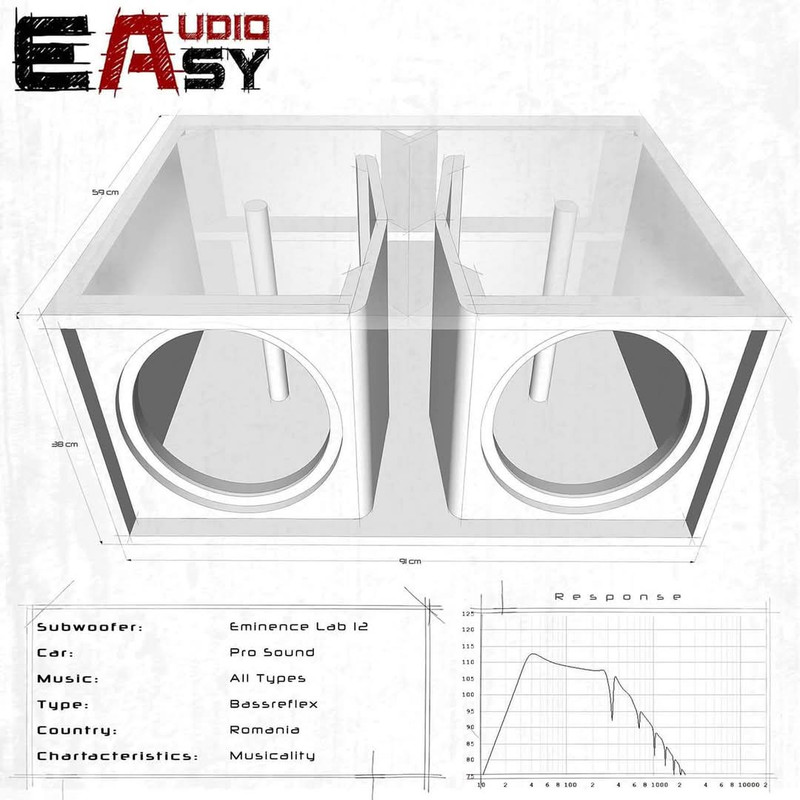

Originally posted by Florin Gabriel Florin Gabriel wrote:
​Hi, DMorison!
Thanks for your question.​You've hit the nail on the head; it's a deliberate combination, optimized for extreme performance (SPL & Low-End) and requires advanced processing.​
Enclosure Engineering: The subwoofers (2x LAB 12) are a Bassreflex-horn design tuned to 35 Hz. This provides a much deeper bass (Low-End) with high SPL which is essential for modern music events.
Faital pro12HP1060 tops are chosen to have the necessary power headroom and to keep up with the Lab 12.
Florin Gabriel
Sounds interesting.
Are you able to share anything about the design of the sub please?
Given the LAB12 drivers have low sensitivity and power handling, it will need to add a bit of gain to let the drivers keep up with the higher powered 12HP1060's, especially as there's 2 of those on each mid-top.

Quote Are you able to share anything about the design of the sub please?
One of the links is to a drawing of the bass cabinet. It is just a bass reflex design with a slightly flared port. If that is the design being used there is no way it will reach 140dB.
Of course the link might just be to a random drawing.
Oh yeah, I must have overlooked that, thanks.
Completely agree, multiple of those would be needed for good bass to 500 people outdoors.
​Hi, DMorison!
 ...it's a deliberate combination, optimized for extreme performance (SPL & Low-End) and requires advanced processing.​
Florin Gabriel
 With respect, I wouldn't be building a system from scratch that I knew was going to need a lot of processing, there are plenty of high quality 18's about now that would give you spl and low end from a compact cabinet without a lot of processing.

Post Options Post Options   Thanks (0) Thanks(0)   Quote fudge22 Quote  Post ReplyReply Direct Link To This Post Posted: 13 November 2025 at 9:12pm
A  2 x 12 reflex sub shouldn't need much processing. It could be a language problem either English or technical terms.
The Lab 12s work well in a reflex cabinet, and would be a good choice for home system. For PA work Ciare, BMS or Faital Pro drivers offer more Umph at the expense of slightly less bass extension.
If the OP is OK with the levels they produce, even if it isn’t actually 140dB, happy days.
