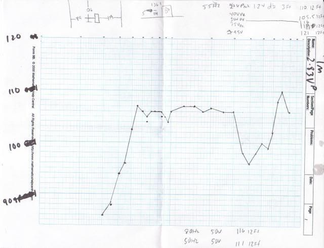

its hard to model in hornrep.  the attached pic is one box  open space 1w into 4 ohms at 1m.  The 65hz dip goes away when 3 or more boxes are coupled.  even though the kilomax doesn't have the strongest motor the horn loads it down to about 40hz.  the drivers don't reach Xmax anywhere in there operating range at 1000W rms.  this is partly because there is no rear chamber.   the sound is very good up to around 100-110hz.  bass notes and timbre are clearly defined without the hard sound of some boxes designed for high spl.  has to be used with strong midbass (kick boxes for UK guys) for most music.  i sometimes use them with dual 15 frontloads tops for the drum and bass partys.  BTW, i have never blown a kilomax 18 from over power.   i run 1 box a side with crest a 9001.

here is the plot.  also, i meant to say "ground plane"  not "open space"

Thats also a lot of weight and a pretty short horn path length for the size of driver by the looks of it. 105 or 106dB average is pretty good and the response is quite flat to 40Hz but I reckon you could get the same with a pair of 15s or 12s in a much smaller box
Ive seen kilomax used in horns and reflexes before and the 1000W is a bit of an overstatement, that massive heat sink aint for nothing! While it may take 1000W a sound engineer friend of mine did some tests and you dont really get any improvement over 500-600W, certainly not the 3dB you would expect to get, more like 0.5dB or 1dB
