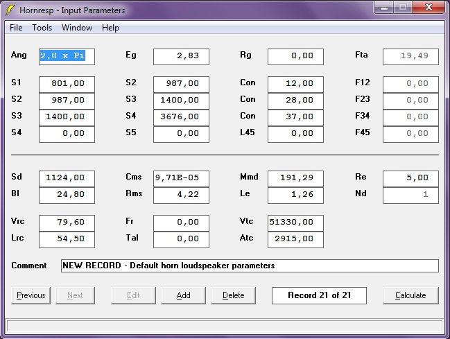

Please someone take a look at this and help me.

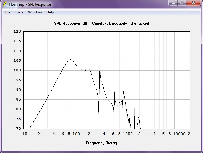

Black is Faital 18HP1060 grey is B&C 18 TBX 100 in simulation of ES 18 BPH.
What I'm doing wrong here?
These are the parameters of 18 HP1060 driver and ES 18 BPH box.

What your doing wrong is loading a "kick cab" with dedicated subwoofer chassis.
The plot is right! Try something with a lighter cone like the B&C 18PZB100 or similar. this will make things better, but not perfect. Bandpasshorns just dont perform on their own...
What are you using below them? As you can clearly see, you will need something below!

Now, black is 18PZB100 grey is 18HP1060.
Peak at 80 Hz and f3 at 64 Hz??
I cant believe this is true for a cabinet this size?

well it looks a bit better.. have you tried fane 18sb, or precision devices pd188?

Black Fane 18SB grey PD 188.
There must be something wrong with Hornresp parametars of the enclosure.
 Please can someone with Hornresp installed try to do a simulation. I would really appreciate that!

Its all perfectly fine. It ks a kick bass, not a subwoofer.

From experience 6 es18s with tbx100 play sub on their own quite well

Will these sit on the ground or above subs? If the latter, then set to 4pi

Don't look at a plot of a single F218
