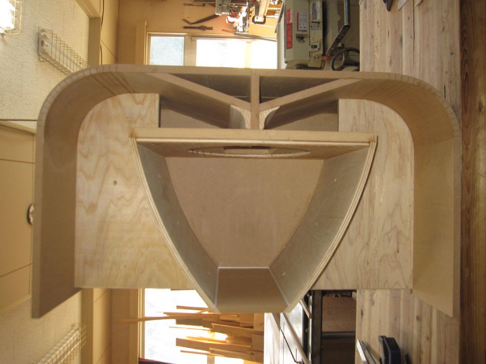

Hi Chris, I had a go at one of the old fane book designs. I chopped and hacked it a bit.  I was just looking through the book and knocked it up one in a morning, I think. J
ust to hear what it sounded like. It was pretty ok. So I made another one looking like the pic just because I could.
I really like how they sound I have 4x and taken them to a fare few gigs now never had anything other compliments. I do do mainly tekno and psy gigs maybe why. But I really like how the voice sounds .
Just my experience. I would say knock up one with cheap ply or mdf and have a listen you might like it.
Hi dollar - that looks fantastic! Well done.
I think I will take your advice, and build one or two, just to see for myself. The Fane book states it's a 1.2 sheet affair, so shouldn't take too long.
I'm still open to other peoples thoughts, and ideas though. Just in case anyone else reading this, is thinking case closed, thread locked. No...
