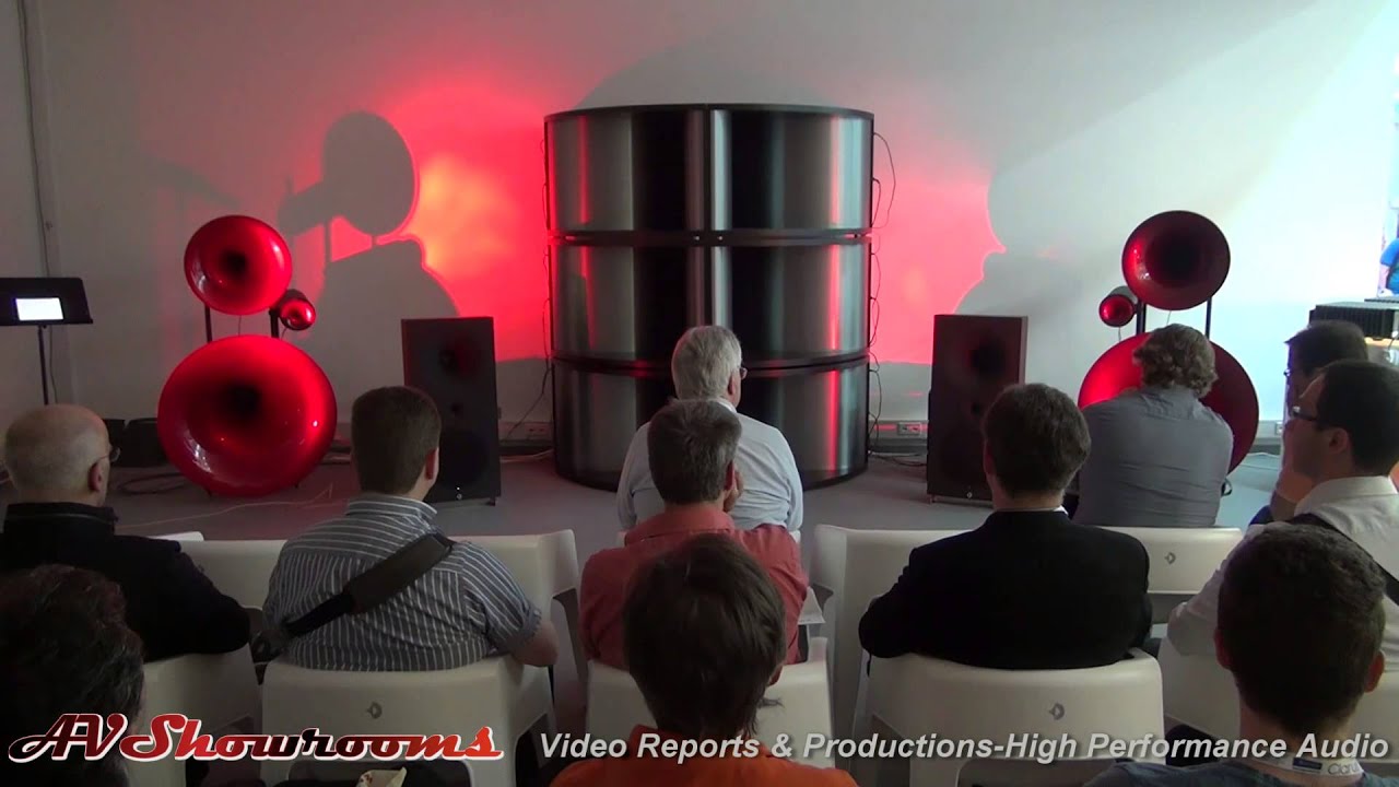

The 2" throat Community M200 midrange driver does not sound like a typical compression driver, and it used in the Avantgarde Trio home hi-fi loudspeaker from 600hz~4Khz.
The Community VHF100 is a better sounding tweeter than the Beyma CPM380 that Avantgarde used, but over twice the cost (use the Beyma for PA, or the very similar B&C DE250). |
