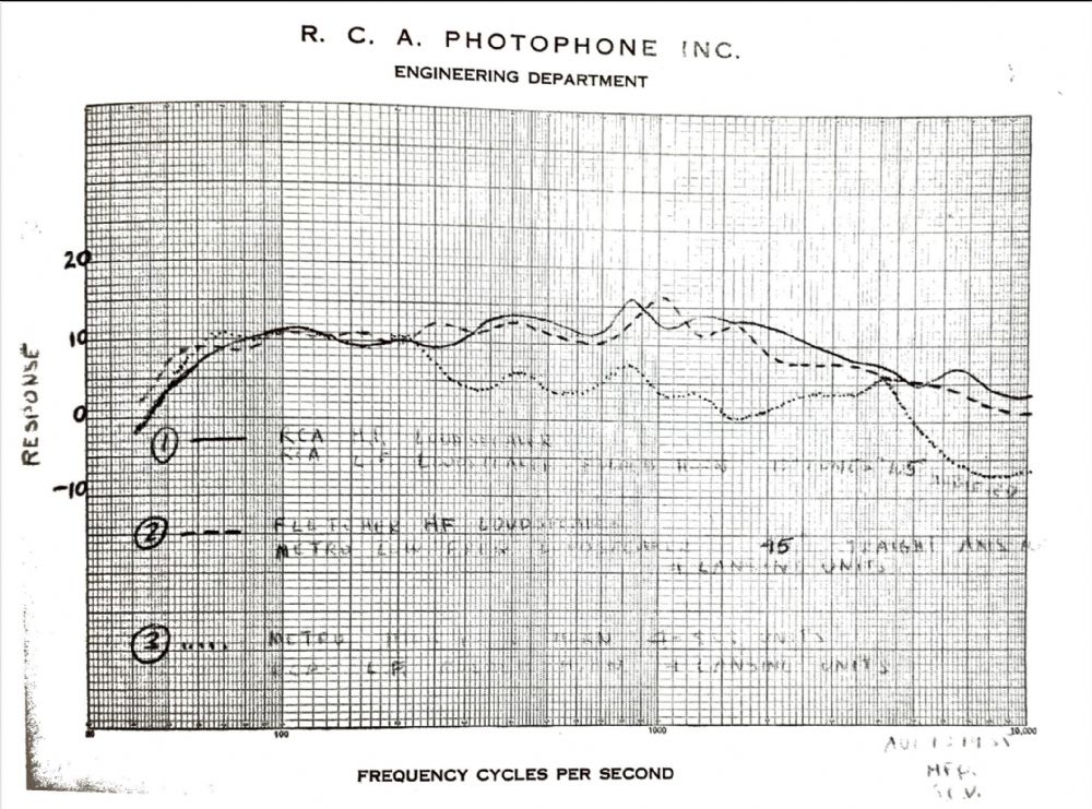

The Shearer horn was actually designed by Olson and Volkmann, and only Lansing used that name for them. They used a 12 dB per octave crossover, and should be a dual-15" re-entrant element if they're originals and genuine. The extra 'baffles' that attached at the sides and bottom make a big difference from the data I've seen.
There's an excellent section on these and other developments of the period in the Horn book from Kolbrek and Dunker. Here's the measured frequency response of the original Shearer horn design, solid curve:
If they could measure their designs in 1935, then surely people doing Hornresp models can measure theirs in 2021
