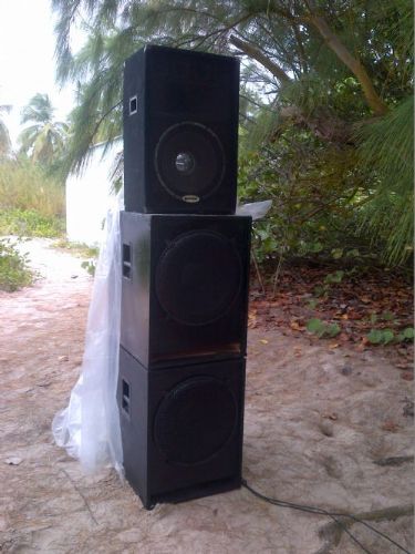

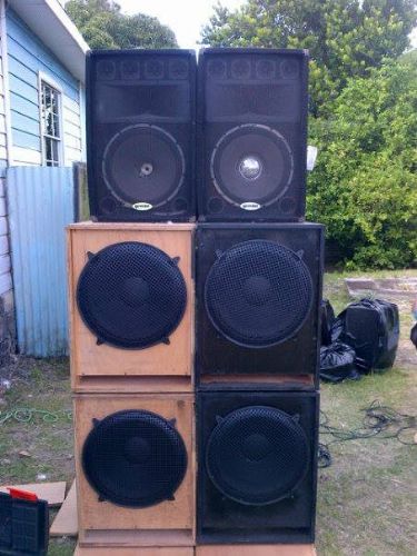

Subs arrived:
![]() ![]() Test Run ![]() ![]() First time going out *sniff* ![]() Put them up against two patent Peavey QW118 cabs my build plays lower with the same settings as Peavey, cut @ 35hz and 125Hz LR24 crossover on a VSX26 ![]() |

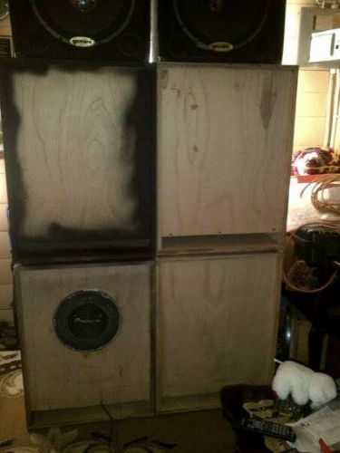

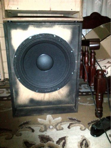

Posted: 13 March 2014 at 5:21pm |
![]() will take propper photos when I paint them (the funny thing about the cell phone crappy photos is I'm actually a Pro Photographer lolololol) |
