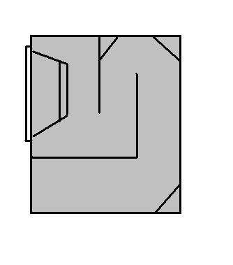

I assume this is what it looks like inside? I have gathered this from looking at photos and stuff.
Can you confirm this tweet?
tweeter box
Old Croc Joined: 21 October 2007 Location: United Kingdom Status: Offline Points: 6784 |
Wrong!
Jake_Fielder you are the weakest link goodbye!
