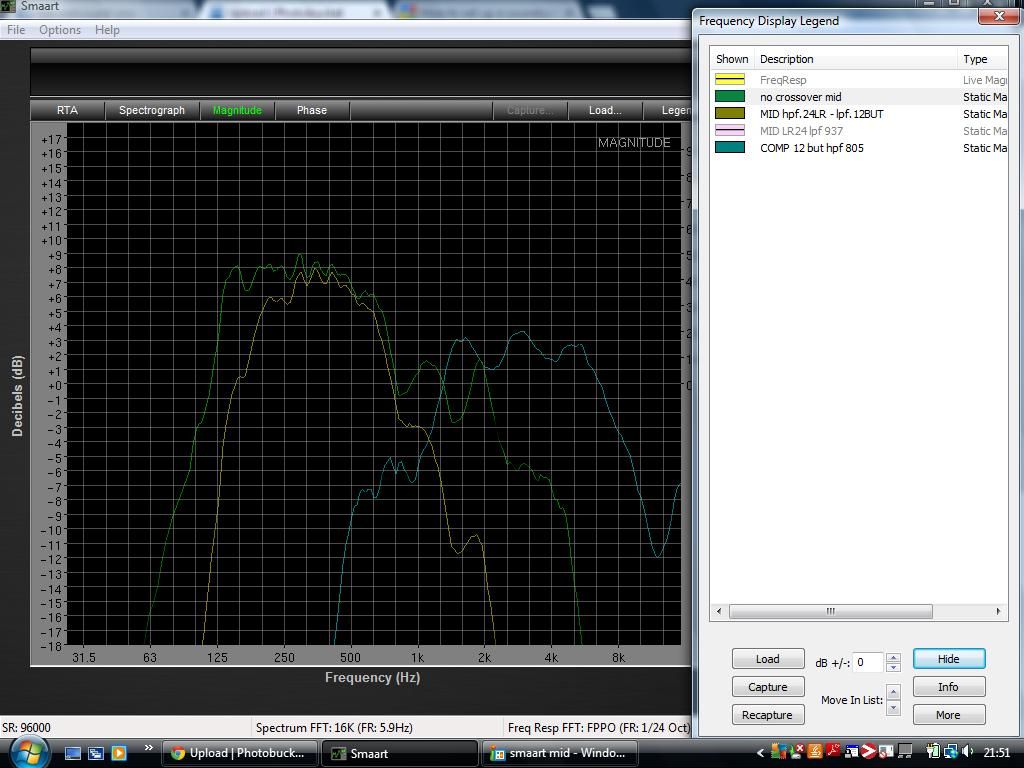

please dont shoot me down straight away as im still learning.
took a plot of my mt and i have a massive dip in the response around 1Khz
I have the drivers in phase. unfortunately i didnt take an over all response, but its much that same as u see here
the problem is that the drivers dont over lap when the crossover is turn off (full range)
green line is the mid with no crossover (full range)
yellow line is the mid with a LPF of 937hz - why do both slopes (green & yellow) go down together surely the green line should go a lil higher or is comb filtering coming in to play?
blue line is the comp with a HPF of 805hz- clearly the comp isnt play down that low
what do u people suggest?
using PD123er
Beyma cp750ti and PH2723
where do people cross the mt122 over?
Edited by Aaronski - 09 May 2013 at 10:25pm

i didn't save the plots, but when i had a quick go at measuring mine, the 12" section didn't do anything really above 900hz too...

Try reverse polarity on the HF. Play the 12 up to like 2khz and measure the response again.
Anyhow i am really puzzled about the HF response. Should go lower.
Edited by MarjanM - 10 May 2013 at 12:43am

Also try measuring in some different positions in case the 1kHz dip is being caused by a reflection from another object, the ground etc.
The scale you are using on the Y axis is making it look slightly worse than it actually is.  If you look at a lot of published SPL plots they will have a much wider range on that axis which will make the dips and bumps look a lot smaller.
I'm not entirely surprised by the results.  A 12" on a non phase-plugged horn and a 2" on a fairly compact horn will only just meet in terms of frequency range.

all though i haven't physically moved the cab, i have move the mic around. i have the mt sitting on another cab about 1meter high. the measurement i posted is with the mic 1 meter away at the compression driver height, is it still possible that i would get reflections at this distance?
i am indoors because i dont want the wind noise ect from outside. the room is 20x20ft with the cab facing out the big double barn doors.

where your taking the plotts could be causing an issue, the 12 looks like its not playing low enougth or high enougth, one tip i tell people to do mith the mt is to let the 12 roll out naturally and bring in the hf from 900 to 1k region.... there is a natural dip around the 1k region with the mt, but not as low as your plotts show.....
The best option is to pick a non windy day and take plotts outside at least 10m away from any buildings walls etc.....
Ill try and find the plotts i done on the 122 and 121, there on my old laptop.....
the green plott looks about right for the low end........ but the top end looks wrong....

looking at the plott your input gain on the rta mic looks to be a bit hot...... you want it around the 0 mark not plus 9.............

Please, take a measurement of the full range. So no HPF on the 12, no LPF on the 12 and 900Hz LPF on the HF. You need to make the correct gain so the lf and hf are on the same level. Looks like that if you put some gain on the hf and reverse the polarity the deep will not be that big.
So one graph on both lf and hf.

Try measuring the 12" section with both the cab and the mic on the floor (just put a bit of foam etc under the mic).  Reflections off the floor could easily cause some odd results in that frequency range.

Re-read the original post.
Quote unfortunately i didnt take an over all response, but its much that same as u see here
Quote green line is the mid with no crossover (full range)
For these plots, the polarity of either is irrelevant.
@Aaronski One of the things that makes your graphs look so alarming is the large vertical (amplitude) scale.
The upper roll off rate of the mids is the combined response of the acoustic and electronic slopes. The acoustic roll off between 500Hz and 900Hz is dominant which is why adding the crossover (electronic filter) doesn't alter things much. You can see that with the crossover the frequencies above 900Hz are attenuated, which is what you would expect with a 937Hz LP filter.
The plots show that the HF section is about 6dB below the mid section level. You need to either turn up the gain on the HF or down on the MF until the flattish sections of each plot are level.
Simply turning the HF up by 6dB will put the acoustic crossover point at around 900Hz, which is about right. and about -6dB below the bandpass levels. Depending on the phase alignment between the sections this should sum reasonably well.
What crossover are you using? If you have a digital one with parametrics and delays I can suggest some adjustments.
