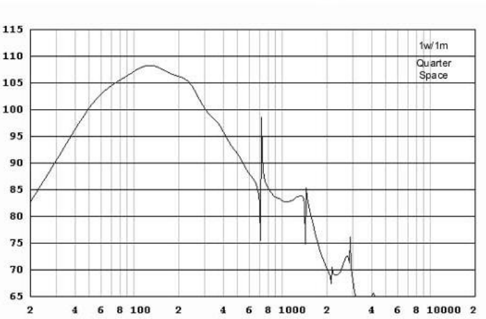

HD15s on sub, will never be fine for Reggae, DnB. Even as a Mid bass cab, compared to others, HD15 is not impressive.. ![]() Freq resp of HD15. Good luck trying to get enough sub out of that, to play DnB/Reggae, to discerning listeners, outside. Also, Beyma CP800TI is a dreadful sounding comp, above 10khz, Beyma CP750TI is much better, and great outside, even on budget, large format horn, like Paudio PH-4525. Playing outside is completely different to playing in small venue, mediocre system will embarrass you and your crew, and blown drivers, due to pushing system beyond it's limits will cause further loss of reputation. If you don't have the budget to build system suitable for purpose, maybe better you hire in 3x 1850 Horns and 3x MT121s. Will have to run the 1850 horns upto 160hz, but will still sound better than HD15s. Edited by levyte357- - 15 August 2022 at 9:07am |

damn...... crowd is 9 people. this is a paintballevent and we play for ourselves at campground, maybe growing some people in the night. no crowd, no audience etc. this the first time i can play the HD15 outside, so thats why i chose them over a 2.1 pa. and bcuz i love horns. i could add a hog or more HD15 but that wont make sense, bcuz our transporter has to carry a shitload of pb-equipment for 3 people and people want to chat in the evenings or in between. so just a slightly bigger festival-rack at the campground. my question was all about, if the 4x HD15 can bring up a reasonable amount of bass or if it sounds weird bcuz of a lack of subbass. now i got a first impressions and thats cool. CP800TI vs 750TI: the 800 doesnt look too good over 10 khz, yep. im not on a budget, would you recommend exchanging them for 750s, or hitting it with the EQ at ~15khz and ~17khz ? i got 4 MT122s so that means exchange 4 CPs. which kickbins would be better for that purpose of solely kickbass? my descision to build these was bcuz i listened to them live and was blown away by that combo (4 hogs and 4 HD15, couldnt get to know which drivers they have been loaded with)
