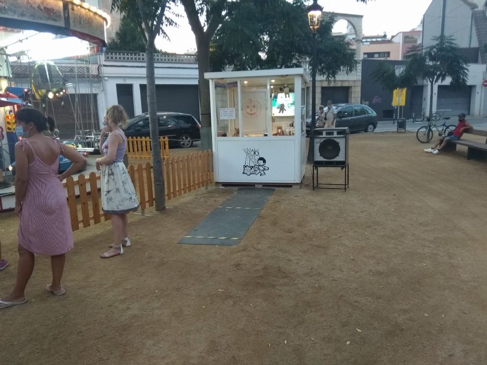

Post Options Post Options   Thanks (0) Thanks(0)   Quote Earplug Quote  Post ReplyReply Direct Link To This Post Posted: 15 August 2022 at 7:09pm
Yes - sometimes the recommendations here are a bit OTT and more directed at large parties & Big Bottom Nutters!
LOL LOL LOL
And down here, some of the systems you see at the attractions at the fiestas can be ridiculous - also OTT overkill.
Which is why I loved these:-
More than adequate for the job they needed to do.  Smile
