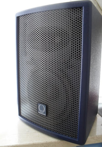

Hello to all you friendly people,
As the title says, I am looking for a low/sub woofer to combine with a pair of Turbosound TXD-081 speakers I have lying around here. Here's a specsheet:  ftp://ftp.turbosound.com/datasheets/txd081.pdf
Absolutely amazing speakers; very loud, good quality, compact... well, I just like them very much for the money.
The speakers are powered by the Crown XTi1000. Good amplifier with build-in audio processor. And that's pretty handy, but not really comparable to the real professional stuff.. Here's a specsheet: http://www.crownaudio.com/pdf/amps/139472-3.pdf
The amplifier suits reasonable to the speakers. But for good headroom in all situations I would recommend a amplifier from around 500-600 watts @ 8 ohm (rather than 275).
And now my question to you guys: what low/sub cabinet will suit nice to my turbo's?
I know a lot of subs will do the job. But I am looking for the PERFECT MATCH (and I'm the critical type of guy).
I was thinking of a 15" BR? Double 12"? I prefer a single-driver cabinet, because of the costs.
Sound quality is the main desire. Second is the sensitivity or SPL. Third is the size. WEIGHT IS NOT A ISSUE! (150kg or 15kg, I don't mind at all)
I hope that anyone nows the answer to this!

I would go for a simple low-tuned 18" reflex box. I would make two with top hats so you can mount your TXDs on poles.  There are lots of easy to build 18" reflex designs out there and they would give good punchy low bass to meet the clear mid of your cabs.  You would need another amp, something that could do sub but you might not need a xover if that amp has a sub out and time alignment won't be ness.  Would be a nice little system if you spend the money on good components.

I was happy with my Ciare 12.00SW loaded mini sub and other people have built similar with the BMS 12S330 (which can go a bit lower in a similar size box at the expense of sensitivity). As the maximum continuous SPL of your tops is only 116dB I'd go for a single 12" with either of the above or similar drivers. I'd also use 4ohm drivers to keep the cost of powering them down.

Single 15" reflex is almost certainly the way to go.  For example I've got a couple on the go at the moment which are a Beyma 15LX60 in an 80L box.  Won't go very low (ie below about 45Hz) but quite efficient and very compact.

Bandpass won't go high enough to cleanly meet the 8", you need a direct radiator.
Hybrid horn/reflex systems tend to be very efficient but also quite large.

My double 8" units are looked after by a single 15" per side pretty much like the box you described i.e. 80L tuned 42hz.
