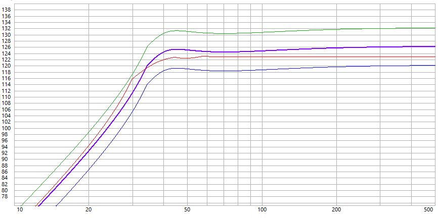

A party in a house no? A lot of systems recommended on here seem overkill to me too. I am curious what size houses some members of this forum hold their parties in, and how far they are from their neighbours. In most urban locations even the single 12” cabinet described in this thread is excessive. Do they not give a shit about people who live close by, or is it a case of wanting large cabinets because they look impressive rather than actually needing the full performance?
Back to the more technical aspect. Assuming that a single cabinet solution can contain multiple drive units, the following plots show the maximum output from four different cabinets.
The bottom graph shows the single 12” in a 40 litre cabinet, with an output of approx 119dB down to 40Hz and a -3dB at about 35Hz.
Next graph up, with just over 3dB more output is the PD186 in the cabinet shown of 183 litres. Obviously bigger speaker, bigger, better, output, therefore much better party. But is an extra 3dB with a cabinet more than 4 times the size worth it?
If that extra few dB output of the single 18” is critical to get the party vibe going, but in a more compact cabinet, the next graph up shows the output from a 2 x 12” cabinet at 80 litres. So a couple of dB more than the 18” driver in a cabinet less than half the size.
If the visual impact of the larger cabinet is a must for party pleasure, the top graph is for a 4 x 12” cabinet of 160 litres. Still slightly physically smaller than the single 18” design, but with 8dB greater output at 40Hz you probably won’t be able to hear complaints from disgruntled attendees who were hoping for at least an 18” drive unit”

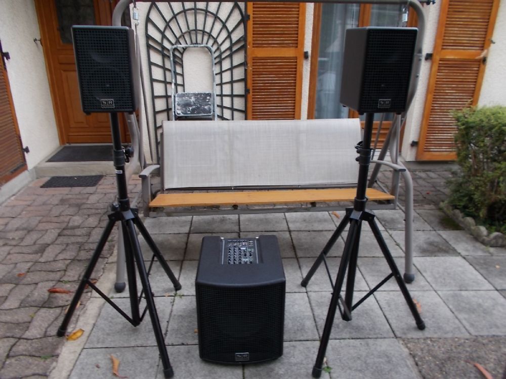

sr technology pocket 750 mx 12 " sub small monitors this is the baby system its been out nuff nuff times loud for it size lift whole system with one hand perfect for disco LOL  if if playin diff type of music bigger systems comes out to play  Big smile

had it a few years now always reliable great sound and loud for its size no effort to carry it LOL  used to use high power 18" subs and high power 15" on top for disco subs were about 45kg each tops about 28kg !!  LOL  them days gone all active these days and compact Big smile
