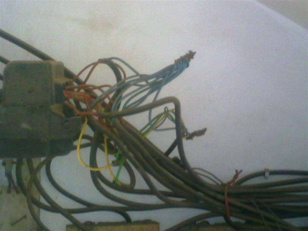

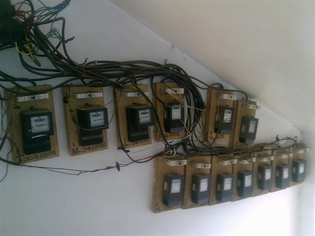

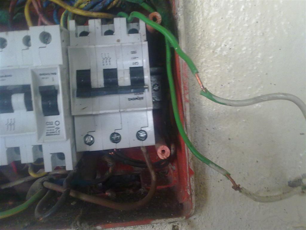

A while ago I was in Ethiopia for a 2 week visit, I saw some amazing electrics:
This was in a building which had multiple small businesses:

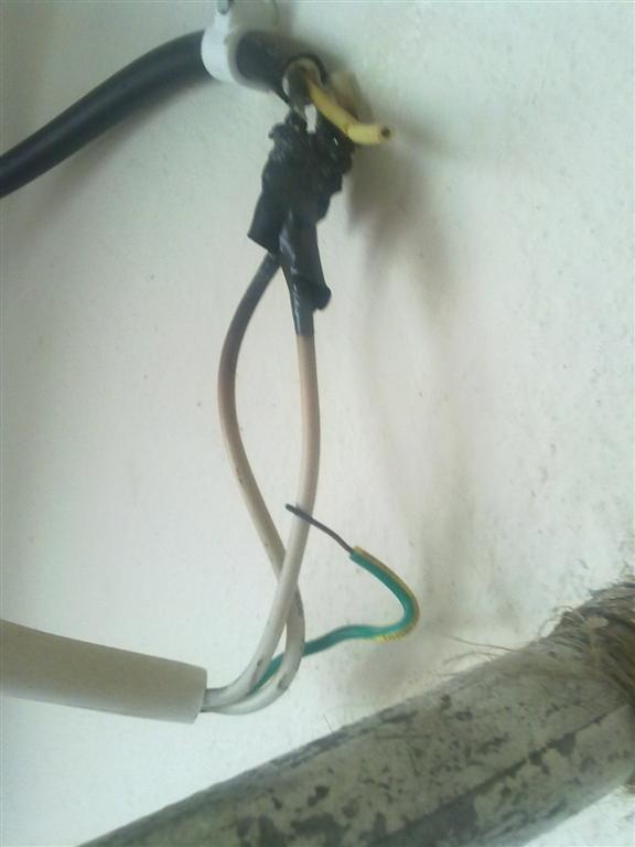

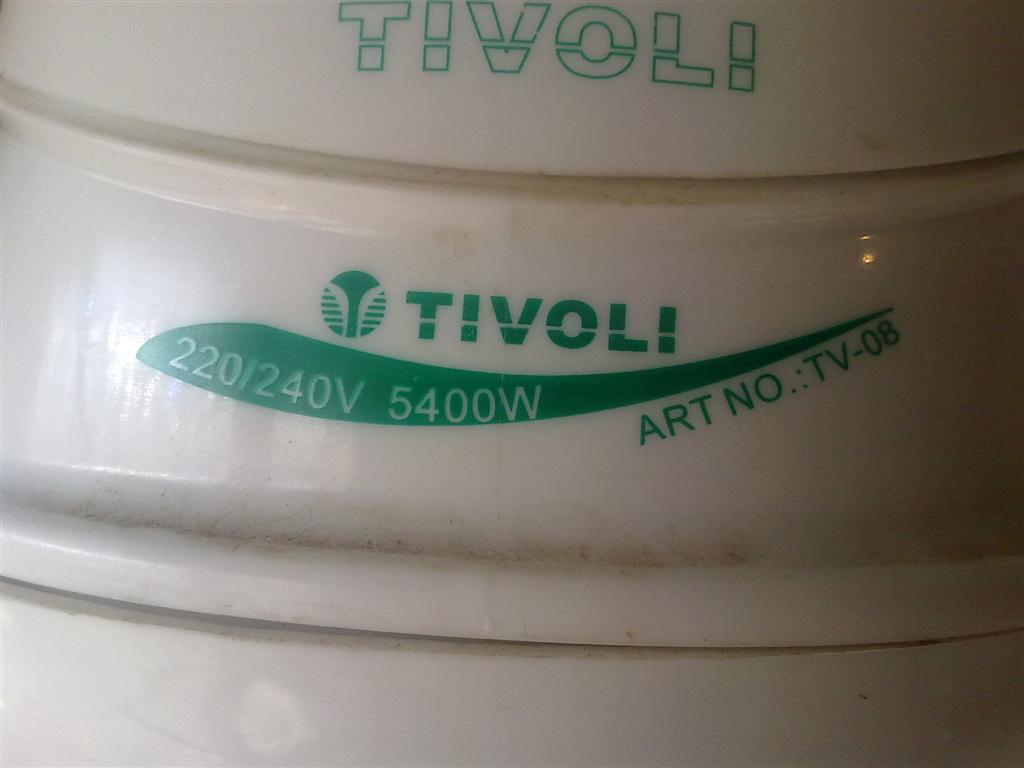

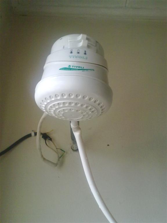

And more disturbingly, the 'shower' my girlfriend had been using for months (the water is heated in the showerhead):

Some of these are funny, but that shower head is just genuinely terrifying >.<

I know we all moan and complain about regs sometimes but the above pics show why they're there... well, some of them anyway!

That shower rose water heater contraption, how on earth will it heat water quick enough? it would have to be as hot as the sun for the speed water will travel through it. What a very silly 3rd world design.

that showerhead thing is mental! Wouldnt catch me anywhere near that!!!
on the other hand, 22.5amps should be enough power in a hot country  to warm water up on the fly, isnt much less then UK showers. Strange old design though, something tells me ill never see one of them in the UK!!
Mykey, you are assuming there is actually water pressure thats gets anything close to a decent shower. Taking showers in Addis Ababa consists of timing between actually having power and actually having some water pressure.

You can actually work it out, I remember this from school physics (a very long time ago). The specific heat capacity of water is approx 4.2 joules per gram per degree C, in other words a 4200 watt heater (100% efficient) would raise the temperature of 1 litre of water by 1 degree C in 1 second.
