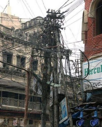

 Kids could get near that
If only! LOL LOL LOL
To be fair, the thing was closed and padlocked (which I had to cut off) - and there is a big (yellow) warning notice in there...  Tongue
