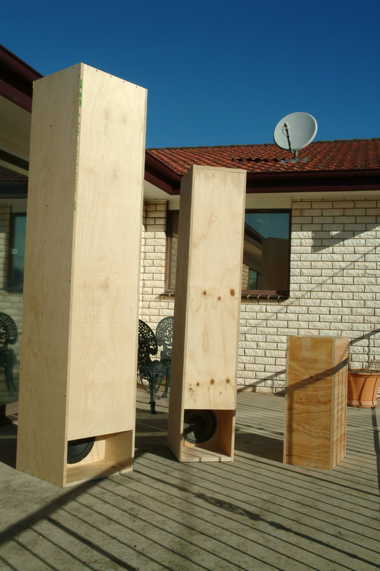

The Tapped horns that you have mentioned are all optimised for PA use - That is to say they are tuned for loud rather than low. None of them are Subwoofers. There are a few exanples of low tuned tapped horns but because of the long path lengths needed they tend to be very big.
https://www.cowanaudio.com/
These are also very old examples and  probably need an update.

As an addendum. The photo Xoc1 posted shows the Cowan cabinets I mentioned above, which I wrote prior to his posting. It better shows the need for a long pipe.
