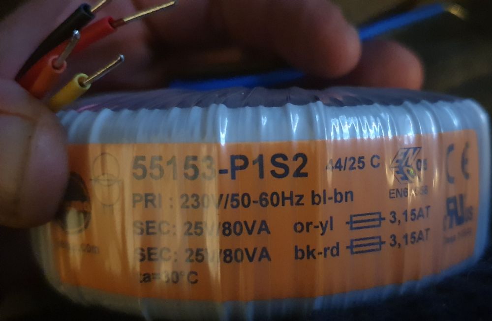

Received the transformers and I have a newbie question.
I ground together 2 ends of the secondaries I presume but does it matter which side of the secondary?
Orange and black to ground, yellow and red are the two 25v legs?

Try yellow and black to ground.. No harm if it is wrong unless if you short a pair together.

Yes, try one pair and measure the voltages. If you don't get summation, swap one of the ends!

yellow and black together become your centre tap

Ok yellow and black it is, thanks all.

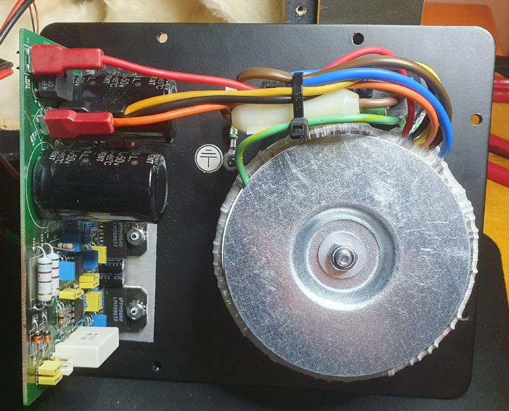

Damn, now I hear a very very faint buzz coming from one of the 8 inch drivers that I didn't hear before because of the transformer (no input).
Could that be something simple?
The old transformer secondaries were twisted around each other before the pcb, is that an interference thing?

The large filter caps are "leaky"? Or try put a couple of 100nF caps across the rails. See if that helps.

where is that earth wire going near the transformer?
I knew someone was going to comment on that.
It's just jammed under that large washer. It used to run to the base of the old transformer because the old one was mounted in rubber, and therefore it needed it's own ground. The new one has a bolt going through the grounded aluminium plate so it is now unnecessary, so I just jammed it under there.
Both the earth wires, that one and the one connected to the plate go to the earth pole on the power connector.
If the capacitors are dying it could cause a faint hum?

take the earth wire out, if it touches the washer it will damage the transformer.
