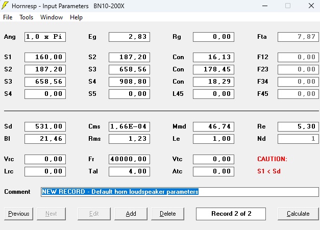

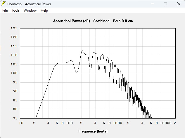

I’m also trying to learn hornresp so I can simulate different drivers but I never get the same results as the simulations in the thread, is there a guide someone can recommend as a starting point? I really want to learn.
i was messing around with simulation some drivers, is this the correct way to do it?
Its the Precision Devices PD.121/2 8 Ohm
Edited by roopes - 09 July 2023 at 11:43am

Post Options Post Options   Thanks (0) Thanks(0)   Quote DMorison Quote  Post ReplyReply Direct Link To This Post Posted: 09 July 2023 at 1:44pm
You haven't modelled a tapped horn though, so of course you're going to get different results.
Double click on the field you have marked Nd and change that to TH.
As a sanity check, if you're still learning hornresp, start with the same driver that Anders modelled too, just so you can be sure you've got all parts of the model correct, before trying other drivers.

Post Options Post Options   Thanks (0) Thanks(0)   Quote roopes Quote  Post ReplyReply Direct Link To This Post Posted: 09 July 2023 at 2:10pm
that solved the problem and i now get the same simulations as Anders, thank you! Finally i can start messing around with different simulations on the tham10 and tham12
