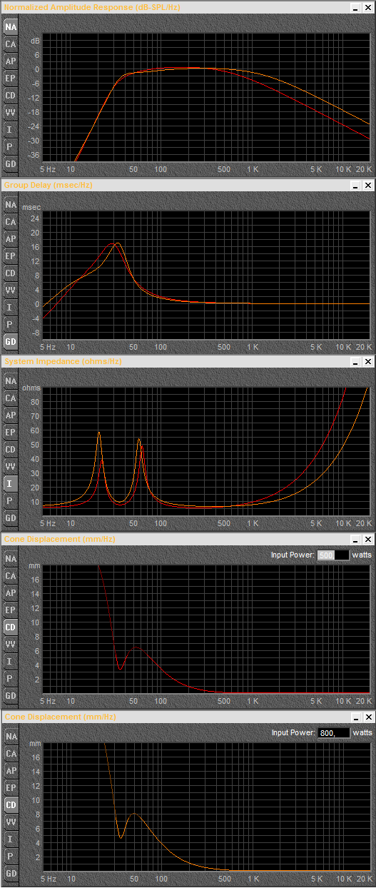

technofreak
Joined: 24 August 2008 Location: Estonia Status: Offline Points: 74 |
Posted: 06 September 2010 at 3:34pm |
They seem to be quite similar. In a 200 L box tuned to 35 Hz both have average maximum output of about 124 dB, but Fane is ultimately a bit louder below 50 Hz, whereas Thomann's is a bit louder above 60 Hz and has a bit smoother group delay curve. Both should be within their X-max limit at their RMS power - Fane's calculated X-max [(Hc-Hg)/2] is 6,5 mm, in spec sheet it's 7,5 - (Hc-Hg)/2+Hg/10; using this formula on Thomann's offering, we get 6,5 mm. If the Thomann's driver has good and consistent build quality and parameters, it should be one of the best budget 18" drivers. Red - Thomann 18" Orange - Fane XB |
