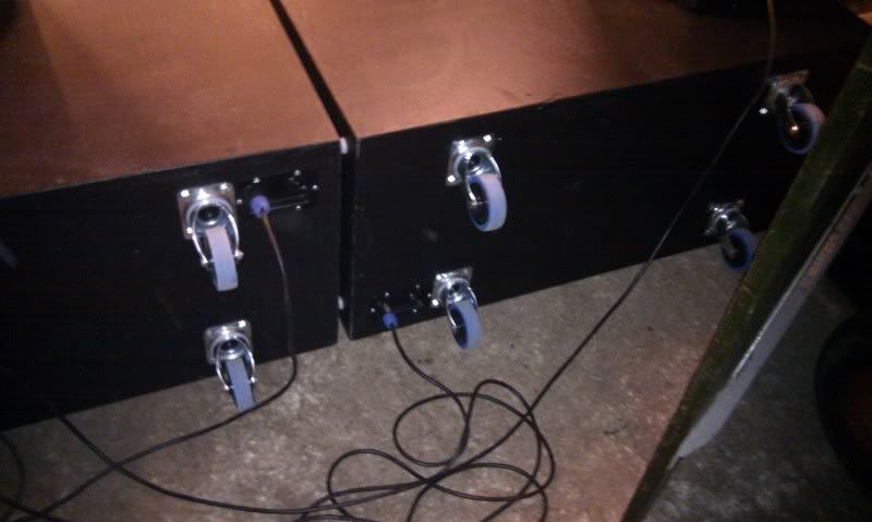

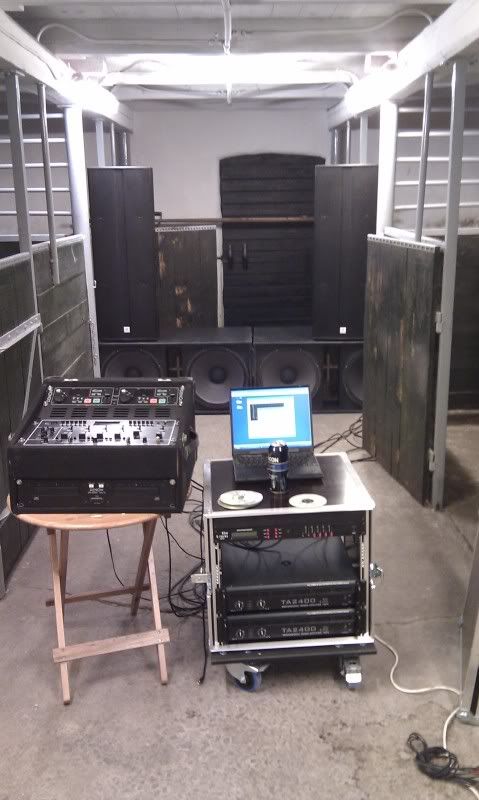

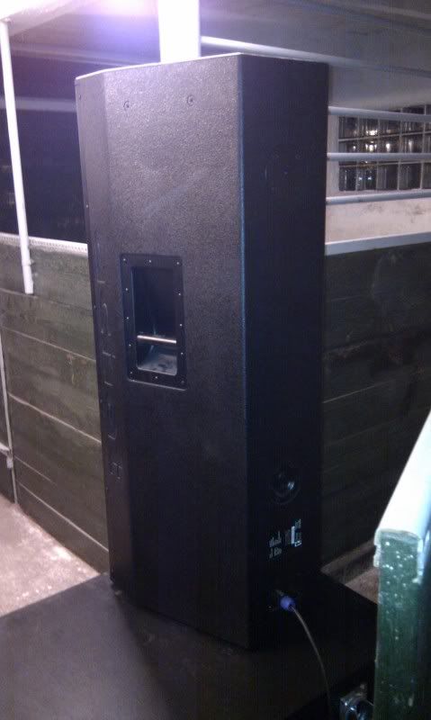

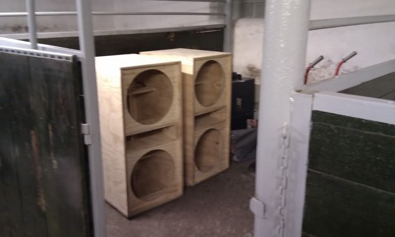

Post Options Post Options   Thanks (0) Thanks(0)   Quote Walle_W Quote  Post ReplyReply Direct Link To This Post Posted: 08 November 2010 at 3:03pm
So i“m almost finished with my Gsubs. Only grill left..
I sold all Tapco stuff and bought a pair of The Box ACHAT 215 instead.
Also got another 2400 instead of the 1400 i used to have for tops.
But the most important thing is that iĀ“m halfway with my second pair of GĀ“s Big smile
Maybe i will try some XB“s this time. Not desided yet..
Thomann x4 = 488euro
Fane XB   x4 = 888euro

This is only a hobby for me, so i have no hopes :)
Outing the rig for the first time on saturday. I have not seen the place but they say it can hold 200p. I will be doing it for free this time since it's the first time and i can't give any guaranties that my rig lasts all night :P
But i'm hoping to be able to do "normal" parties and disco's (club it's called today i think? :S) up to 300p? And small Dubstep events up to 100p?
In GƤvle, Sweden
