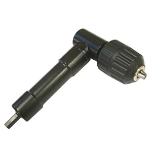

If it's only 5mm you should be able to use a chamfer bit on a router.
Set it so that the bearing just about catches the inside wood.

Thank u infa but my prob is i can only gt my trimer round the bottom half of cut out as the chamber gts narrow at the back ?
